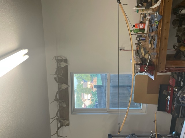

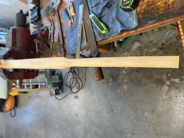

Heres a 60/40 lever bow profile out and getting legbone sinew backed from deer we harvested here at our home. Bow is currently drying for several months til sinew is totally dry.
HH
reverse strung while drying

Last sinew is on bow. Back has a nice crown to it. Has 7" of reflex now. Just have to wait until Oktober to tiller the bow.

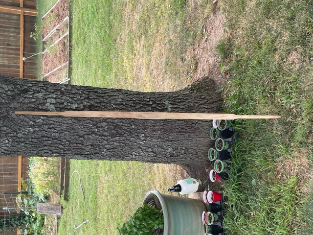

Have been working on a bunch of Osage blanks for the Tennessee Classic in May. Few Hickory's in there too. This pile of Osage is from 2019. Good looking wood and should make some very nice bows.

The Osage staves look great, very straight not twisted, I wish I had one ore two.

Lucky to have some pretty good Osage that grows or was planted here many years ago. One of those staves is a very nice HHB Sapling.
Working on a Pyramid 68" billet Osage currently. Need to profile it today.
